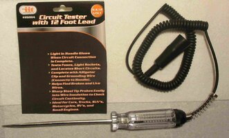

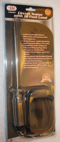

...and a perfect "On Topic" time to make mention of getting a decent Insulated Lighted Circuit Tester Probe for Checking Powers & Grounds, Circuit Continuity and Fuses. Similar versions to this one are available on Amazon:
