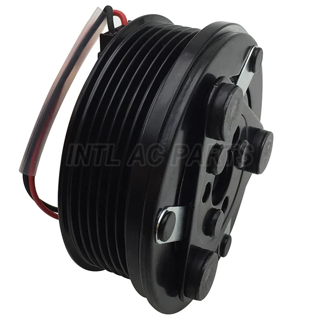

Might be a little late however, for anybody looking (because my clutch just got smoked), I did find a clutch kit on AliExpress:
Problems though are that it's only $30USD but shipping is $50USD. That comes to $104CAD. Other problem is that it would take about a month to get here, if at all with the current problems with shipping from China.
I'm probably gonna look for a good used clutch or grab the whole compressor if it was a recent replacement before being scrapped. Not too many candidates in the yard at the moment.
