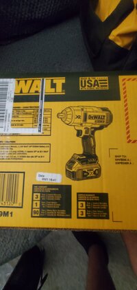

But I did go and get a 20v max xr impact from home depot last week, 1200ft lbs of merican nut bustin' torque, Unfortunately it didn't hold up.. idk much about impacts, but never seen one act like it did.. so, I'm pretty sure it was gone. But I did order a replacement and it was here waiting for me.
And as far as not using the impact, I'm really hoping the reason you shouldnt do so is why I was having problems w my impact, I wouldn't say it's stripped, but def. Has stress marks. Looks like the vertices were pressed to a point. Hope I didn't f*** up. I'll add some images.
And I do have a 15mm deep impact socket & breaker bar that ill go ahead and try out, if you guys are able to reply before I'm able to get back to work, any tips/tricks to any of these steps?
And what is the consequences of using an impact? I'm not disagreeing with ya, just would like to know if I could continue with; it? And why is the hb installer kit so expensive for a bolt and a few washers? Would I be able to go to a hardware store and make my own for a fraction of the price? I got a rental from autozone but the guys up there aren't the best and brightest and pretty sure it's completely the wrong set. I'll include pics of all tools/kits I've bought/rented (And I'm on an increasingly tight budget atm, the impact and all other specific tools/kits more than likely are gonna be returned after the job) but I really need to get this envoy up and going asap!
And as for the case relearn, (I read the process listed but so damn tired rn my bad if it was already mentioned) is there any way to avoid dealership? I have a buddy w one of the pricey scan tools but not sure I'd its something only gm specific computers have. I've never had my hands on a scan tool like that.
I'll go ahead and post pics of all tools, kits, and parts. Ik some are pretty irrelevant, but don't wanna leave anything out I might be able to use that I'm not aware of. Lmk if there is Anything I'm missing or could have to make the process run smoothly.

To answer your Questions about whether or not it is wise to use an Impact Gun to Remove "The Jesus Bolt" from the nose of the Crankshaft:
(1) The GM Atlas LL8 4.2L In-Line (6) Cylinder Engine sports an EXTREMELY LONG Crankshaft that is made from Nodular Iron (CORRECTION comes courtesy of @Reprise) unlike the completely ordinary method of Melting Pig Iron and Sand-Casting the Crank inside of such a Mold like the the Crankshafts of Old have been made. The LL8 Crankshaft IS Strong but not nearly as Strong as having a Crankshaft formed using the the Drop Forging Method on a Pure, Red Hot Steel Blank or by means of a CAD Machined piece of Cold Billet Steel. EDIT: Friday, June 18th, 2021
(2) All of the Vibrational Forces being created by the ever increasing speed of rotating the Mass of the Rotating Assembly (Pistons, Rods and Crankshaft) occurring within the GM Atlas LL8 4.2L In-Line (6) Cylinder Engine transmit that Energy with greater and greater amplitude ...LONGITUDINALLY. So the ONLY thing keeping that recombination of Excessive Vibrations from tearing the Motor apart... is the perfect mating of the Two Part Elastomeric Harmonic Balancer to the Nose of the Crankshaft. Using Heavy Hammer Strikes or the forces imparted when using an Impact Gun can serve to "De-Tune" the Crankshaft, Stretch the Internal Threads and ultimately interrupt or change how those Vibrations are mitigated in all ranges of RPM. You will never find any mention of "Use an Impact Gun" when performing the R&R of a Harmonic Balancer in any GM Service Manual for this very reason.
(3) In cases where an Impact Gun with Great Power is used on "The Jesus Bolt" for Harmonic Balancers that WILL be re-used (not in your case) the sudden, jarring forces imparted by the Gun can damage the Bonding of the Elastomeric Material in between the inner and outer sections of aged Harmonic Balancers ...causing the more massive Outer Ring to slip and fail. The other consideration is to remember that TTY Bolts are S-T-R-E-T-C-H-E-D and left under Tension during their OEM installations and behave to some extent like "Metal Rubber-Bands", thus fighting against Impact Gun strikes during the removal process.
(4) The worst thing that can happen now, is to wind up further Damaging the The Hex Flats on that in-dwelling HB Bolt and then have to DRILL IT OUT to make any further progress. Right Now... In addition to everything I mentioned in Post #13... Your Very Best Friend will emerge once you obtain and use a 1.5" x 3' Long Galvanized Steel Plumbing Pipe slipped over the sturdiest 1/2" Breaker Bar you've got in your Tool Chest fitted with a Brand New Impact Grade Deep Socket that marries with the Old Harmonic Balancer-Crankshaft Bolt as snugly as possible... and just LEAN INTO the Pull as a Slow, Steady and Deliberate Force... and THAT Bolt WILL Yield.
