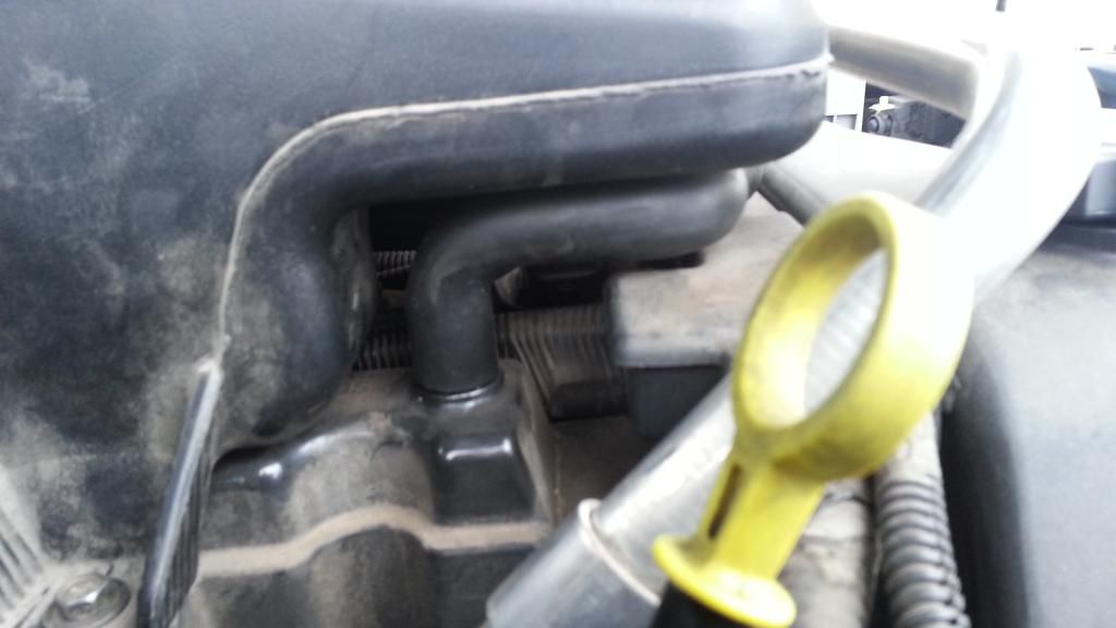

So a several weeks ago temps dropped into 20's here and the engine would idle rough, almost stall and the service engine light came on. Last year when it got cold same code came on and it was the filler neck hose at the tank was completey loose. Tightened it up and was good to go. So my first thought was filler neck crack at the tank. Couldn't find anything in evap system and was getting ready to try and get a smoke test done. $115.00 at dealer, but they would wave it if I had them do the repair. Local shop was $89.00 plus repair. After researching how to make my own smoke machine, I suddenly remembered the hose at front of the air box seemed slightly loose when we cleaned the throttle body a month earlier. I took a chance and ordered it through the dealer, $17.00, replaced it and reset codes. Looking at the old one where it connected to the valve cover, there were a few verticle cracks where it connected to the valve cover. Sure enough that allowed air to pass when it was cold, which effected the idle and then kicked the code. New hose is tight on the nipples and for last 2 weeks plus all is well, runs better each day, also we've gotten a few mpg better around town and highway. The dealer said it was the pcv hose, didn't find a pcv valve tho. Hope this helps someone with their TB..... Merry Christmas Everyone!
Here's a pic 4.2L engine:
If you have the 4.2L engine, there is no PCV - the 5.3 does have one, though. However, there is a vent hose to ventilate the crankcase, perhaps that is what the dealer meant.
Yes I forgot to put that in, 4.2L engine, trying to get a pic uploaded to show. Thanks...

Just to clarify; The 4.2 has a PCV system. It does not have a PCV Valve. That's the main reason the T-body gets so dirty.
Yep, though technically it's because of the side that goes into the intake manifold (that's why it gets all over the backside).

do you have any pics of the cracks in the old hose?
No but if you look up the hose you will see cracks that run up into the hose where it is supposed to seal around the connections.
TB2004 said:
No but if you look up the hose you will see cracks the run up into the hose where it is supposed to seal around the connections.
As you saying to look at mines to check? Sorry if I misunderstood, but yes my hose has cracks on it too I just didn't think it made much of a difference until i saw this thread. Just wanted to see a pic to compare but I'll just replace it when I get a cai lol
Yea replace if any cracks, helped mine alot. Sorry about long delay.
