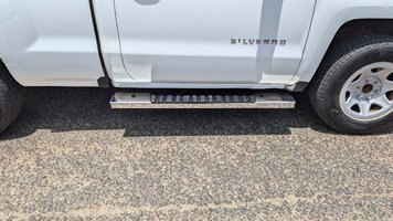

This how it looks :)
No more stress for me and passengers
I am Danny De Vito size so I need steps
Or die when getting off the truck 🤣
