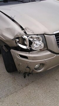

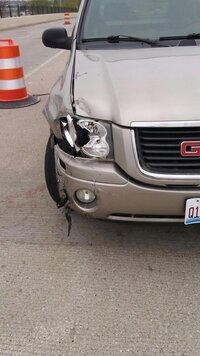

thank you much, just got a message from my dad, rear ended someone.. didnt even have the car for 2 weeks!!!!
hopefully no mechanical damage, looks like passenger fender, hood, bumper and headlight damaged only.... says it drives normally still.... gah so pissed off
Damn that blows. Hope everyone involved is okay.
ya the guy he hit, took off. so not sure what the deal with that was, dad is fine, hes just as pissed as me. he is so used to driving smaller cars, sunfire, cobalt, i warned him, envoy brakes a lot slower than what he is used to driving. he does love to wait till the last second to brake... but all is fine. just gotta do some more work to the envoy now :)
Ouch! Well that sucks! Um... not to be mean, but he IS going to pay to fix it right? I mean, he's the one who busted it up...
Makes you think that the guy he hit was an illegal or had no license or something if he took off like that!
