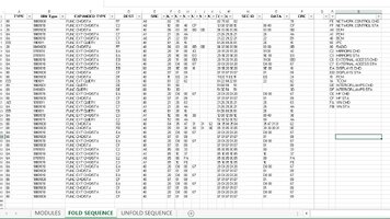

Google Sheet
  • FOLD.txt
    FOLD.txt

Basically, I was able to fold/unfold a passanger mirror with a Class 2 message and I suspect there's no way to fold/unfold a driver mirror via Class2, cuz DDM connects to it phisically and does not need a network command and no other modules (and neither tech2) can command to fold/unfold mirrors. But I might be wrong. Any input is very welcome.
If u want to try it urself, send this message:
6A C2 A0 85 00 33 (33 is CRC, not needed if using telnet or putty).
C2 is a functional address of mirrors for command, defined in J2178
A0 is message source, in our case DDM, ,defined in J2178
85 is probably an action, this byte is MF specific
00 means both sides, defined in J2178
you will receive this:
8A C3 A1 85 1E 37 (37 is CRC)
C3 is a functional address of mirrors for status, defined in J2178
A1 is message source, in our case PDM, defined in J2178
1E means PASS side
So, PDM confirms that the PASS mirror is folded or a command accepted (I didn't figure that out yet).
I attached the entire network traffic for folding to this message for reference.
I'd like to warn people that those SAE standartds are NOT Harry Potter and are NOT an easy read. People who can easiliy read and comprehend SAE standards usually don't have friends :smile: It took me some time to get an understanding of what's actually going on. I will write a detailed post soon with network messages, my analysys steps etc so people can follow.
I will give TCCM a try over the weekend and will report back.
PS. My setup: Win10, BAFX Bluetooth, putty. I do have a Chineese MDI knock off and Tech2Win, as well as ACDelco subscription for SPS for 1 VIN ($40 for 2 years), but it's not requred for this particular exercise.
Peace, Pavel
Google Sheet
Thats close to what I sent.
I sent a Priority 3, type 10, message operation = "Load Command Extended" message to Primary ID "Mirrors", Command ID: $C2, from source F1. The secondary ID was 05 (see table 32, 2178-4), with the Q bit high that becomes 85. The extended address I sent was 00 for "all" (see table 55, 2178-4).
This folded both mirrors for me but as expected only the PDM responds with a "report status extended" message.
I suspect you only folded the passenger mirror due to using the the source address of the DDM. One could hardly expect a module to act upon a command message sent by itself!

Amazing!
I found a caveat.
You need to wake up the bus first, that is what FF 02 command is for or press buttons on devices conected to Class 2 to wake up the bus "manually". Without it other modules are not accepting commands, they sleep. I was wondering last night why sometimes my commands worked and sometimes they did not.
I didn't figure out last night that 05 plus high Q bit equals 85. It makes total sence now. Secondary ID is only 6 bit and it completely escaped me.
Now, if you noticed, when you fold mirrors from the button, they first go to the most down position and then fold. When you unfold them, they also go from the most down position to some stored position. I suspect that position is stored in BCM (as Driver 1/2 settings or maybe just last mirror position), so modules need to request that info from BCM. I will try tonight to find that peace of communication and report back.
Anyway, I am extremly happy as this is my first dive into a Class 2 universe and I can't wait to do more cool stuff. Thanks for chiming in and helping me
I have noted that sending a message twice can also "wake up" a module but it is true, there is a method defined in 2178 for bus wake up, an 02 sent to Primary ID "Network Control", Status ID $FF.
Do you already have the other two volumes of 2178?
There is a message related to mirrors I have not figured out yet. Look at the spreadsheet image I posted of your "fold.txt" doc. Lines 2, 23 and 24. On line 2 the DDM sends a load command extended message to the mirrors Primary ID/Command ID $C2, the secondary ID is "12" and the extended address "00" (all). The data byte 1 is "40".
On line 23 the PDM reports an extended status of this parameter (12,00,40).
Line 24 has the DDM acknowledging this status report extended from the PDM.
I see this exchange repeatedly, before and during my data recording of moving my mirrors using the trucks native controls.

Let's recap what we know so far (Line by line):
#1: DDM wakes the network up
#2: ???????
#3: ??????
#4, 5: DDM & PDM report state of respective ajar switches. 21 means Ajar switch not active (Table 34, Q=0, C=0, SecID=21) and 26 and 22 front driver and front passanger (Table 56)
#6, 15: BCM ack information from lines 4 & 5. 26 means 21 ack (Q=0, C=1, SecID=21), 26 and 22 same as above
#25, 26: Ovbiously, the last 8 digits of my VIN (I checked :smile: )
#31, 32: A command to fold the mirrors and an ack from PDM that this command is received on PASS side.
#33, 34: A bit confusing to me. DDM tells mirrors do not fold, and PDM reports that it didn't fold them???? What does this mean? Or maybe it means Load the state of the mirrors and PDM responds that the stae is folded. (Q=0, C=0). 31-34 are still a liltle bit confusing to me. Are we ack a receiving of the command or an execution of the command. Looks like we ack the receiving and DDM than requests the status to make sure that the mirror is folded
I think I figure out exactly Lines 31-34. In 31 DDM is commanding to START folding (literally it commands to load Q=1 (which is Enable) into the state of the command fold, ie starting the execution of the command. In 32 PDM ack that the state of the command fold is now Enabled. The mirror is folding now. I'm sure there's a overcurrent protection in the circuitry of DDM and PDM, however, in 33 DDM is commanding to load Q=0 into the state of the command fold, ie commanding to disable folding. and in 34 PDM ack that the state od the command fold is now 0, ie the mirror has stopped folding.
What it means that if we maybe can fold the mirror part way, if we give the command to stop folding soon enough. I am going to verify my hypothesis on the car and report back tomorrow.
update: part way folding didn't work, once the mirrors started folding, they will continue untill they fully folded.
another update
Line #2: moves PASS mirror down or up. The same command moves it down first, but if issued again, the mirror moves up to the previous position. I'm not sure what it means
Pavel
In the past sometime I saw a value for current flow of a folding mirror. I think it was using my tech 2. Anyway, my data has timestamps and it can be seen there is about a 4 seconds timespan between these messages. I am thinking the DDM and PDM monitor the current draw of the folding motors amd issue the stop command when it is determined the action is complete.
Testing shows this to not be so. The "6A C2 A0 05 00 FA" occurs while mirrors are still in motion.
I tried to issue this command immediately after 85. My mirrors kept folding. Can you try it on ur Yukon?
Already did that. Appears to have no effect. Also tried to request the extended status of the 05 and 06 parameters but it appears that such status requests are not supported for the mirrors. I know my message structure is correct because I can succesfully request the status of door ajar switch status' by querying 'external status' $C6.

Any chance you could make a public version of the spreadsheet? I love the idea, but I have no idea what I'm doing when it comes to making spreadsheets like that
Btw, how did you add timestamps? I could't find this option nether in putty, nor in some other more fancy terminals
The thought has merit. At present there are no instructions. That isn't a big obstacle as I could write up the basic steps to generate and load a log file in and view the results. However, at present the spreadsheet is tailored to work with a log file of a specific format and will fail if presented with a different format. An example would be the log uploaded by @iddqd , had no timestamp. So I had to concatenate something in there. Easy enough for me but might be daunting for another.
The sheet has been made to work with my specific vehicles. It's a work in progress and constantly evolving. Things pop up and are addressed as I get information. For example I have a module address in my Yukon I have not yet identified. All I see are the "node awake" and a request for throttle position from it. If some vehicle data is loaded and it has an unknown node address it may get misrepresented in the deciphering.
There are also a lot of somewhat hidden things going on in various pages of the sheet that are easy to run afoul of.
All that aside,,, won't know till it's tried. So here is a link to a copy set aside for this purpose... There is a sample logfile from my 2002 TrailBlazer during a sort of slow motion startup sequence where I paused between each action... I'll see about putting together a basic how-to
My logs are gathered with Android App "Bluetooth Serial Terminal" by Kai Morich in the Google Playstore. Timestamp is an available option there.

Well I just a moment ago realized I had not properly set permissions for that linked copy of the spreadsheet! Just corrected that.
We could do both... Post your log files here and I'll load em up and you should be able to grab a copy of the spreadsheet (I think?) And have a go as well.
When working with the spreadsheet give it time, it's slow.
Most straighforward way is to open sheet1, select the entire column A and clear it. Don't delete it! Just clear it. Post your log file (as text, not separate columns) into that column A and save that.
If the format of the text is correct then Sheet2 will split it out into the needed columns. This process removes the 03 node alive messages but if you want to see them I can tell you how to eliminate that filtering.
The 'Output' sheet should have the decoded results. It also displays the raw data waaay over to the right starting at column AV.
If you want to pick out certain data quickly for review, on the 'Output' sheet, cells H2, I2, and J2 are references used with conditional formatting rules for those columns. Copy/paste in a value from that column into the appropriate #2 cell and matching values below will highlight.
Now if all that works and you want to load both data logs put the second log in another column in Sheet1, like column B for example. Now back on the 'Output' sheet go to cell A1 where it currently reads 'A'. Change that to 'B' and it will load the data log in column B of Sheet1.
The spreadsheet is not fast, at least in my experience. Takes some time for it to work through all the layers. Best to work with small data logs.
