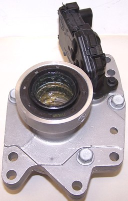

If it's coming from the front, start checking from the transfer case forward: Drive shaft/u-joints, differential, axles, disconnect, stub shaft in the oil pan. You could jack the front end and turn each wheel by hand. Another thing you could do is jack up all 4 wheels and secure on jack stands, engage 4wd and put it in drive. See if you can pinpoint where the noise is coming from.

There are two parts to this. The disconnect is the mechanical part that is bolted to the oil pan and has the axle going into it. The actuator is the black plastic "motor" that is on the disconnect and actuates it.
