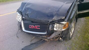

hitting a sunfire going 80 Km
Not enough frontal damage to have set them off.
Sensors are apparently on the inside of the bumper bar that's under the bumper cover. IF they're not touched, the bags don't go off.
Well, at least that's what I was told when I had my little accident and my airbags didn't go off either. :undecided:
These SUVs are built very solid - gotta love "body on frame" construction. :thumbsup:
dazingla said:
you would think hitting someone going 80 and flying into a ditch the airbags would of deployed
Glad you weren't hurt. I assume you would have mentioned it if you had been. So if you didn't stretch your belt enough to hit the steering wheel with your forehead, the front end didn't collapse enough to even break the windshield (did it?) and your grill and headlights are relatively non-shattered, the airbag controller did its job! It held off the deployment in case you had a SECONDARY impact when you went off a 100 foot cliff on the side of the road after this hit deflected you.
Airbag deployment isn't like in the movies. It's basically a shotgun blast 12" from your ears that's meant to save your life in higher speed unsurvivable accidents. It's not a pillow to make sure you don't break your collarbone on the seat belt or your nose on the steering wheel if you position yourself with highly bent elbows too close to the wheel like some extremely short people do. It turns tragedies into celebrations of life. You get to greet friends and relatives in the hospital instead of having them sign a funeral home guest book.

i was actually the passenger my wife was driving. kids in back seats. All that happpened to us was minor injuries except i have a partial torn ACL in my right knee and some whiplash. Gf has back problems and kids are fine. Except now my 4 year old has an excuse not to clean his room. Every time i ask him to pick something up he says my leg fait mal(my leg hurts) lol .
Accident happened almost a month actually exactly a month ago today.

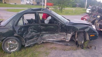

Too bad for the Envoy, but glad your family's a-o-k!! Wouldn't have wanted to be the passenger in that Sunfire. :eek:

thanx mike . if there was a passenger in the sunfire he would be gonzo. the passenger seat was stuck against the drivers head
I know when i worked for AUDI the airbag sensor worked off the DELTA-V formula.
Basically a change is speed. So if you hit them at 80 but you were still doing 60 then you didnt slow down that much that you were going to hit the windshield or dash. With it being a sunfire it just didnt slow you down enough for deployment.
I always thought this as well. It is not the impact, its the deceleration that deploys the bags.
There was one AUDI that had the whole front ripped off his car. Some how not sure but the driver lost control and the front end was basically removed from the car. But the car was sliding side ways at 60+ mph and the front was sliding against the inside barrier. Hence it was a slow deceleration but a lot of damage.
And as others have said having an airbag go off between your arms in front of you is and needs to be a last resort.
