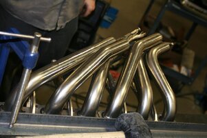

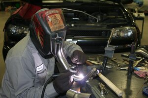

A couple pics of the header build.
Bartonmd said:
I would think the header would need to be done, first... Look a little closer at the picture...
Mike
Lol, bet it sounded nasty if they fired it like that. :cool:
There were a couple of kinks in the inital design. Chris told me it should be done on Friday. Then it is off to the dyno.
look at all that room in there.... has to be one of the easier header installs
It looks so much better than the rusted hunk of cast iron. I can't wait to see how it looks when it is finished.
