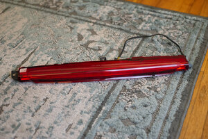

While I was at the yard I snatched another 3rd brake light to mod with LEDs. Ive done this already but it didnt turn out well and I did not seal it good enough which caused some LEDs to die.
This time I baked it open which worked VERY well.

It was the older model, 02 or 03 I got it off of. Neon?! That's super cool and odd af.
Thanks for the knowledge
That's it, my 02 had it and they went a different route in 04 onwards.
