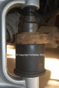

I removed original ball joints (BJs) and installed Moogs with the captive rubber seal. Autozone-sourced BJ press.
Items used to remove lower BJs. Note large impact socket is not part of kit.
On it's way out after straightening the staked flange with hammer and punch. Impact gun rattled, then BJ popped down about 1/8 inch. After that it was pretty easy to slide it the rest of the way out.
Pieces used to install lower BJ;
Be sure BJ is clocked appropriately--the rubber seal at the bottom has a grease vent that goes inboard. That way excess grease can't "POP" the seal, and the excess grease is vented away from the brake rotor. Installation was a two-stage process. C-clamp is not quite tall enough; I had to start the BJ with the spacer ring removed. Once BJ was partially-inserted, there was room for the spacer ring (not in photo) between top of control arm and stepped adapter shown.
Snap-ring installed, grease zerk got another ~90 degree turn after the photo was taken. I poke an awl or small Allen wrench into cotter-pin hole of BJ stud, swivel the stud to align the cotter pin hole fore-aft for easy insertion (and later removal) of cotter pin.
