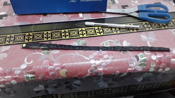

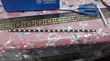

Finally got them finished. I would have wished the lights were about .3"-.5" bigger and I could have gotten a 4.5" version but those did not come with mounting and adjustments. Ended up having to paint the Iris shrouds and chose piano black. I would have preferred then chrome but I messed them up when clear coating. Maybe later I order a new set sometime in the future. It's hard to really make out the shrouds in pics.
IMG_20180225_170954.jpgIMG_20180225_163555.jpgIMG_20180225_085911.jpgIMG_20180225_170529.jpg
1524127038124.png1524127062654.png20180416_111617.jpg20180416_112858.jpg20180416_130036.jpg
Will try to upload more pictures later as the internet is acting up. The retrofit is 90% completed, just need to finish the alignment of the projectors and seal them up. Will post a cutoff pic which I need you guys to help me with.

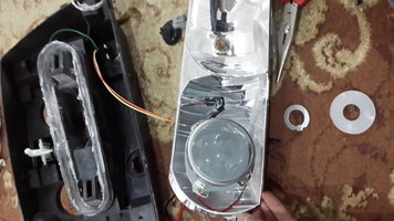

That's a good start so far. I agree with @dna59, since your projectors aren't sealed, if you don't use a shroud you're going to have all the light that bleeds out from around the projector lens bouncing around off the reflector bowl and go in many directions besides where it's supposed to. Granted the haze will block some of it... :redface:
Are you going to polish up those lenses before you seal it back up? That will improve the light output quite a bit, and allow for a more clear view of those LED strips you're putting in.
@$ Khalid ! 9130 you didn't want to use a shroud for the projector?
The one that came with the projectors was too big and don't fit properly and didn't look really good
Oh yeah I have seen the light bleed from the sides. What I plan to do is get a sheet of aluminum, cut it to required size and fold around the openings in the projectors to form a nice cylinder
Yeah the lens are really bad. I will polish them before I seal everything up

I think those lenses are really screwing with your light because there isn't really a cutoff there. How's it look without the lenses?
I hope all that light bleed is a result of not having a shroud on there. That output is not good at all. Can you share a pic of the shrouds that came with them? If they are anything like the tons of choices we have here, they are plastic with a chrome finish. You can put a sanding drum on the rotary tool you used to cut open the headlights, and shave down the shroud to the shape that will fit comfortably inside the reflector bowl and behind the bezel.
I'd say take an output shot without the lens on it. That way can rule out if the lens is messing with it and to what degree. I can't make out anything remotely close to a cutoff in that pic. I'm assuming the projector is oriented correctly. Even without a shroud I don't think it should be that bad.
Could be. But I'm quite certain it's due to having no shroud on
Will post some pics later. It's just that I don't like the way they look more so than the size. Just a personal preference.
Will try to get one but will be a bit difficult as I'm preparing to travel. Hopefully when I'm back I can pit more work on them. From what I'm seeing, it's the gaps on the projectors since there's no shroud where light is bleeding out which is getting reflected by the original reflector housing of the headlights and just creating havok

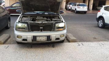

Well put my projectors back into the TB. This is the output im getting :
20180513_212359.jpg20180513_212629.jpg20180513_212412.jpg20180513_103743.jpg20180513_212352.jpg
The passenger side seems to be a tad higher than the drivers side includong the highbeam. Any advice on the output. Im not really sure if thats how its supposed to come out. The output though is waaay better than before, just the cutoff seems wonky

Your way to close to that wall for use to even have a clue as to what your cut off line looks like.
The best cut off line I've gotten with that type of retro fit is this.
Editing... stand by....
Reactions: $ Khalid ! 9130
Ahh well silly me!! How far should I be from the wall approximately. Thanks 😁
:undecided: I think you have some adjustments to make, so you can improve that output.
First off, from about 20 feet away from the wall you're using to align the beams, the step in the cutoff line (and the hot spot) should be 2 inches lower than the projector height on your truck if you're parked on a level surface. The beams should never go up, and it looks like yours are doing that, especially on the passenger side. Biggest problem is, you're going to blind other drivers, 2nd biggest problem is your light isn't hitting the road at distance where you need it.
I'm assuming all of those pics are with the projectors in low beam mode correct? If that's the case, you may need to adjust how the bulbs are seated in the projectors, as you don't have a well defined cutoff line, with the bright hot spot on it. Here's a shot from when I first tested out my RX350s, with their OEM frosted lens, but aftermarket bulbs before I modified them with clear lenses.
Depending on any variation in the angle of the bulb, you can move the hot spot up/down. This will also (un)focus your cutoff line. You should open the bulb clip on one projector, and disconnect the bulb from the other side. Fire up the headlights, and tilt the bulb up/down, and see how the output changes. After you figure out what gives you a better cutoff line, you can shim the bulb so that it stays in that position when the clips are closed.
Having a clean cutoff line will let you better tune in the rotation so the lines are horizontal, and line them up with each other. :two cents:
I agree for the passenger side. Its higher than the drivers side. But it's not just the low beam. The high beam is also a tad higher as seen in my post two posts back!
That's because the passenger side isn't aimed correctly. You can use the headlight assembly adjustment to aim the whole bucket lower to match the driver's side's height, but as unfocused as your cutoff lines are, it's difficult to tell how good your rotation is.
On a side note. There was a mechanism for switching the beam from low to high. I just completely removed it. Could it be that it was there for the low beam and since i removed it the projector is in high beam mode??
Um, yeah. If you removed that moving shield, you'll never have a cutoff and you're stuck in high beam mode.
Yup that could be the reason right there. Any particular reason as to why you removed it?
Well there it is 🤪!!!!
The reason I removed it was because I thought it was only if you were going to use the bi-beam feature. Well guess its going to go back in 😊
Yup that's the entire shield assembly which gives the cutoff line and control light output. You should see a big difference.
Yep, even though its soo bright outside i can already kinda see the difference. Can't wait till it gets dark. And to think i had ripped it all out throw in the garbage :duh:
Much better for sure. Did you put the solenoid back in or just the shield? It looks like you have a little bit of light bleeding through the solenoid mounting holes that you may need to cover up with some foil tape.
