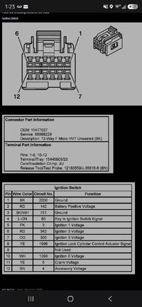

After ruling out the obvious issues, I began tracing the circuit using the wiring diagrams.
According to the diagram, battery power (B+) feeds the underhood fuse box and then supplies Fuse 61 (IGN A1) and Fuse 16 (IGN B1).
  • IGN A1 (Circuit ID 142) runs from fuse box connector pin B9 to ignition switch connector pin 2. Based on the diagram and wire color (red), I believe this circuit should have 12 volts at all times.
  • IGN B1 (Circuit ID 342) runs from fuse box connector pin E5 to ignition switch connector pin 6 and should also be hot at all times.
I removed the ignition switch and checked the connector for voltage. Pin 2 (IGN A1) and pin 6 (IGN B1) both measured less than 1 volt.
Since those circuits were not receiving battery voltage, I suspected the fuse box. However, both Fuse 61 and Fuse 16 showed 12.5 volts on both sides of the fuse.
I then removed the fuse box and performed continuity checks:
  • B9 to ignition switch pin 2: good continuity.
  • E5 to ignition switch pin 6: good continuity.
  • Fuse 61 to B9 through the fuse box: good continuity.
  • Fuse 16 to E5 through the fuse box: good continuity.
  • Continuity from the fuse box power input through the associated fuses also checked good.
At this point, I'm stumped. I can verify battery voltage all the way to the fuses, and continuity checks good from the fuse box to the ignition switch. Yet the ignition switch feed circuits only show about 1 volt.
Am I overlooking something? How can there be battery voltage at every point up to the fuses, continuity through the downstream wiring, but no usable voltage at the ignition switch?
