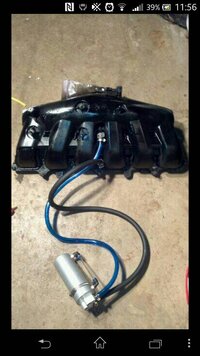

Hi. I am running a oil catch can on my turbo i6 project and I ran it off the L shaped hose on the drivers side that connects to the intake manifold. I ran mine by taking off the L shaped and replacing it with 2 hoses to my catch can.
Appears to be working great. Make sure the hoses on intake manifold and the can are tight or youll have serious vacuum leak issues haha... Learned that the hard way.
I doubt there is a vehicle specific catch can. I just bought one from a nissan forum online when i was looking up some random info about catch cans, but I assume an eBay one would suffice as long as its decent quality
