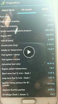

Screenshot of real time reading using bluetooth obd device...
That could be map sensor, O2, lots of things. If you have lean condition PCM will try to compensate with more fuel. Could be onto something with that. I'm sure someone knows these codes and electronics better than I do will chime in
P0171 System too lean (bank 1). May be a vacuum leak.

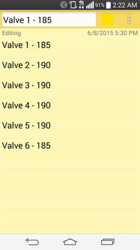

My compression test was positive...
And just 2 days after the plug change, plug well 1 was again filled with oil... I think i see intake manifold gasket change is in my near future...smh.
Pressures look great. And yeah, if it's hemorrhaging oil that quick it's an issue. Better keep your eye on the oil level and keep it topped off.
