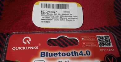

I saw this information mentioned and provided by @Mooseman in another Thread and decided from this Good Sense Suggestion to invest in getting:
A QuickLynx Blue Tooth 4.0 Battery Monitor II Unit:
THIS is How It Hooks Up and Works:
THIS is How It LOOKS:
...with the Images of the Unfolded Instruction Manual included:
QUICKLYNXBM2A.jpgQUICKLYNXBM2AA.jpgQUICKLYNXBM2B.jpgQUICKLYNXBM2BB.jpgQUICKLYNXBM2C.jpgQUICKLYNXBM2D.jpgQUICKLYNXBM2E.jpgQUICKLYNXBM2F.jpgQUICKLYNXBM2G.jpgQUICKLYNXBM2H.jpgQUICKLYNXBM2I.jpgQUICKLYNXBM2J.jpgQUICKLYNXBM2K.jpg
