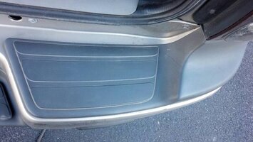

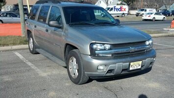

Took a heat gun to my bumpers to bring them back to black heres some pics...
Easy to do and makes a huge difference

Heres a before pic of the front

Wow. What a difference. Nice job! I gotta do mine as soon as the weather improves.
amazing what a little heat can do :rotfl:
looks good :thumbsup:
There a tutorial on this somewhere? Also, looks great!
That looks better than most trim restore compounds that I have used. Plus you do not have to worry about it washing/wearing off.
Thanks everyone. Yea, it is easy just time consuming. Some spots are hard to get to with a heat gun also.
