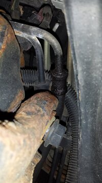

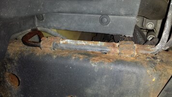

Attached are some pretty ratty looking photos of the area.

Correct. Rubber almost all the way to that factory fitting from metal to rubber, I have it clamped right before the elbow.
Thing is, it looks like your leak is from that factory rubber to metal fitting so running hose won't fix that.
And just a reminder that a simple bit of fuel hose and clamp won't work on the high pressure line, only the low pressure return line.
Thanks.
Your right about the location of that leak. I was thinking of making a coupling there with a piece of metal line if I have to.
I just cleaned it up and there is no rust there at all. I'll dive it a bit to see if its oozing out of the top of the connection. The master cylinder is above, it maybe it got little spillage when I was doing the brakes.
I wouldn't think of doing this on the pressure side, would have to bite the bullet and replace it back to the rack.
I love this truck but a some point it's going to have to be replaced.. hope to get a couple more years out of it.
If that fitting is bad then yeah you could cut the hose right before it, use a double ended barb with clamps and use a short piece of 3/8" fuel line to then connect between that barb and the good spot of metal line.
The second pic looks like another spot is all wet though, where is that at?
Yea that's the part that's heading down to the cooler.
That section would become rubber hose all the way to the other end.
I'd just start new at the cooler with the hose bypassing all that rusted stuff.
