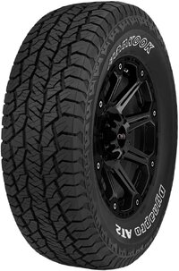

Shopping for new tires, my Yokohama's are almost shot at about 25k. A concerning amount of cracking is happening between the treads and they seem to be wearing out much faster then they should be (already gone past the wear indicator). So since I do my own rotations, Yokohama won't warranty them out without paperwork showing its been done. Tirerack is giving me a discount on a new set, so its tied between the Hankook Dynapro AT2's or Toyo Open Country A/T lll's.
Its a tough choice, both have a nice aggressive tread style and are 3PMSF rated.

How much highway driving do you do? With it's center rib, the Dynapro's are probably going to be quieter than the Toyo's.

Got the new tires installed this morning, slight shipping delay from the snow we had last week. Loving the look, and they're much quieter then I was expecting. Not much of a road noise difference from the Yokohama's, but so far so good!
