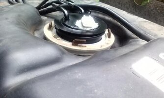

Replacing the fuel pump due to corroded nipples.....:eyebrowhuh: After I pulled the pump I was hoping I could reuse the retaining ring.
Since I don't want to replace the pump again unless it fails, maybe we can slow the corrosion this time.
After I hit it with the wire wheel too much material was flaking off and I didn't want to lose any sealing force from lack of material so I was fortunate there was one local dealer with one ring left.
Unfortunately I needed to supply my own jar.....I figured maybe $10... :eek:
Hondabond doesn't spread easily but I think I have this pump licked....:yes: I don't want to chance anything.
Kids almost learned a new swear word when I dropped the pump in the tank to hear it hit bottom... and remain a good inch above the top. :explode:
I went back and remeasured against the old pump......borderline rage since it's was already in fuel...no returning it.......then I noticed the springs. :cool:
I should have hydrated earlier...The thoughts I had when I turned the key and the fuel pump didn't energize were that of alcohol, then I realized I still had relay #41 out.:crazy:
But it lives, all is good.
