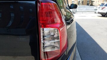

My wife found the Voy's back up lights to be terrible. What I did was switch over to ascender tail light that have the reverse bulbs at a higher point. I wired them with bumper lights and now I have quad back up lights. I also added jdmastar super bright led bulbs back there and my tail lights are now brighter then most car head lights. Lol.20170618_130207.jpg
My wife found the Voy's back up lights to be terrible. What I did was switch over to ascender tail light that have the reverse bulbs at a higher point. I wired them with bumper lights and now I have quad back up lights. I also added jdmastar super bright led bulbs back there and my tail lights are now brighter then most car head lights. Lol.View attachment 82280
Funny, I have the Ascenders on mine too. Maybe I should do what you did in conjunction with the driving lights for the "landing lights" look.
