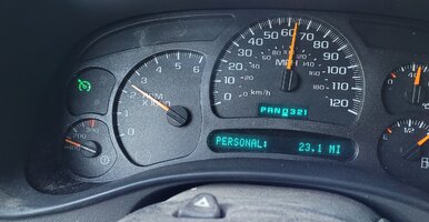

Shouldn't the RPM's be lower at this speed, cruising on a flat highway?
Just checked the window sticker. It has 4.10 rear axle ratio.
Not sure if that matters, the revs still seem too high.
Try manually shifting through the gears to be sure it goes into 4th. Also check that the TCC is working. Otherwise, that looks normal to me. Similar to my 4.10 Avalanche with 6.0L :ugh:

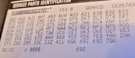

There's no door jam sticker, and I think that's just wrong...
But there's this sticker in the glove box.
GT5: 4.10
LQ4: 6.0L
= Lots of money for fuel :frown:
