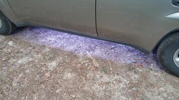

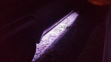

Alrighty, now time for some Pics and VIDEO
lets start with a video I shot showing all the floor "punch outs" in the area I ran my LED strips
https://www.youtube.com/watch?v=r05HmSiDTMs
I used window flashing on both top and bottom of the hole create a weather tight seal since I couldn't find a grommet to easily fit there locally, plus the one on the passenger side is a bit oddly shaped and likely would never find a grommet to work, and just to try to give a better surface for the LED's to stick to I ran strips of the flashing along the under body in the area
https://www.youtube.com/watch?v=LSHWIJQnNk4
after I shot that video I added another layer of flashing to the top and bottom of where the wires went through to get as tight a seal as possible
the wires then run under the carpet to the B-pillar and tap into the courtesy light circuit which FYI is the small group of wires toward the front side of the B-pillar, in that bundle you will find 3 wires (Orange, Grey w/ black stripe and Black) the black is your ground (there is also a ground bolt on the B-pillar) the Orange is the reading lights and the Grey/Black is the courtesy lighting positive, tap into the Black (or use the ground bolt) for your negative lead and then tap your positive to the Grey/Black and now the LED strip will fully function with the interior lights and you are free to repeat the process on the other side.
I have installed the LED strip to the body but I still need to route the wiring over to the B-pillar and tap it in, I think I will also alter My earlier plans to use the extra festoons for footwell lighting and add a few shorter strips of the remaining strip to the circuit.
in the 4 attached pics you have one taken around 7:15PM when it was still light outside and then 2 pics showing the spread and brightness at night (trying to avoid the headlights) and the last pic has the driver door open so you get some additional lighting from the interior LEDs shining on the ground as well.
and last but not least the video of the lights dimming, something about the camera makes it look like they are flickering but they aren't, they dim just as smooth as the interior lights.
https://www.youtube.com/watch?v=d042jeZ9lQg

Glad to see that turned out well man. Real nice write-up with great pics & vids [emoji41]
I'm sure more if us will do this mod now that you've found those holes in the floor, makes it a lot easier to run wire from outside. I may do some courtesy lights too now lol
and it's fairly cheap to do too the strip light is about 10-12 dollars, I bought 2 (30') rolls of 16 gauge wire from walmart at 6 bucks each, but 1 roll of 18 gauge would work, provided you can keep track of which wire is which lead, the window flashing roll was 10 bucks from Lowes (and I still have like half or more of it left, I would suggest finding another use for the rest ASAP) so the whole thing could be done for under 30 bucks, assuming you have solder, soldering iron, hot glue gun (used to insulate the connections at the LED strip after soldering) and some method of tapping the wires together, whether it be butt connectors or t-taps where the new wires connect to the existing circuit.
