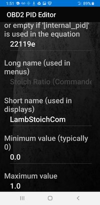

Included are some additional screenshots on a known PID for commanded AFR. I'm sure many have figured this out but thought I'd share anyway as I have not read anywhere that would indicate anyone for sure knew the entire process of how this works. Also included is a custom equation that I created on my own that luckily worked out pretty simple to convert the AFR read out into a Lambda Stoich Screenshot_20191221-135618_Gallery.jpgread out. Because I have a flex fuel my commanded changes mostly in reference to my ethanol percentage.

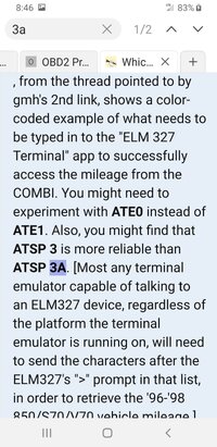

What is this protocol 2A ? The ELM327 datasheet on page 26 lists 13 options, all represented by a single character 0 through C.
Included is An example I believe on a Volvo forum.
Honestly I shared this bit of information Based on a theory in hopes that someone would chime in and better explain this. On some of the apps I have. In order to scan C codes And ABS codes. It generically shows the message ("VPW" / VPW TYPE 2") I also remembered reading from various sources expressing a different flavor of speed with vpw protocol. May not mean anything but the elm command to set the protocol accepts setting protocol 2 and 2A respectively (VPW).
">SP 2
">OK" and
">SP 2A"
">OK."
Also Here is a link to one of many. Website explaining the base protocol is in a little more detail. Some of this information may be bad information. And some of it might be missing other bits of information.
">SP 2
">OK" and
">SP 2A"
">OK."
I have the same results when issuing those commands as well.. However when I follow that up with "AT DP" (define protocol) the elm reports back the very same protocol leading me to think that only the first character is being accepted when setting the protocol.
Edit: just for a test I tried ATSP2B and it was rejected so it would appear there is at least some verification of the 2A command there.

Managed to discover additional Pids after half a day of driving. Wasn't Easy. I have many other things that have not been fully defined yet that I may share later if someone sees this information as useful. Decided to go ahead and share this.
"(Gmc) Door Lock Status (Envoy)","Door_Lock_Stat","22410601","Lookup(Bit(A:2)::0='Unlocked':1='Locked')",0,100,"","6CA2F1","","",1
"(Gmc) Multi_Stat_Mode_(Yukon)","Mult/Stat/M","22110701","Lookup(A::0='Standby': 75='KeyAcc.': 74='Acc.On': 73='A/C,RelayOff': 72='A/C,RelayOn': 67='IgnitionReq.': 66='OpenLoop': 64='ClosedLoop': 11='FcRapidDecel': 10='IgnitionRet': 9='ClosedThrottle': 8='OpenThrottle': 3='FC/Decel': 2='SemiOL': 1='Lean.Decel')",0,128,"","Auto","","",1
"(Gmc) Right & Left Rear Window (Envoy)","RR&LR_Window","22210F01","Lookup(A::131='RR/Up':67='RR/Down':11='R/L_Up':3='Set')",0,100,"","8C40F8","","",1
"(Gmc) TransRangeSwitchSel (Yukon)","TransSel (Yukon)","22111301","Lookup(A: :1='P':2='R':4='N':8='D':16='3':32='2':64='1')",0,100,"","8C10F8","","",1
P.S. for the left rear window. The "down function" is read out by a different PID, but I have not yet figured out how to add a different PID readout in the equation to read two different pids in 1 gauge. Specifically for a "bit encoded Pid". Can someone help me out? If someone can show me i'll share the "left rear window down function" pid.
