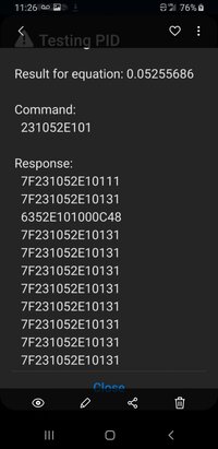

I have been using mode 23 as well. From my observation the first of 3 PID bytes or mmeaddress in the pid field seems to be able to contain a module header id (40 for BCM). Regardless a 2 byte memory address or pid attempt (bytes 2 & 3) gets shifted in front of the mode upon an affirmative response. Example,
Send: "23"10"52E101"
Recieve: "6352E101000C48"
Otherwise "7F231052E101XX
I have tons of memory addresses for our vehicles to test.
What is the 3 byte header you are using for this command seen in the attachment? To my limited knowledge a
Service 23 messages are meant to use physical addressing to one intended target node.
With regards to your 7F general response messages as far as I know the last byte indicates the type of response. "11" = mode not supported, "31" = Request out of range and so on. See negative response codes here...
The single positive response in your screenshot is interesting.
I am running a broadcast header of 8CFEF8. I thought you would take interest in the positive response. I was interested to hear your thoughts or anyone else's on that matter. I am familiar with the error codes. The reason there were so many was because of that broadcast header. I have been issuing commands: AT AL, AT H1, with my test runs as of late as well, although you will not witness that in the responses in that instance. The result is very interesting indeed. Thoughts?

Good morning. Finally got my ELM327 yesterday and have been playing with it. I noticed that in an earlier post it was stated that oil pressure reading is spoofed by the PCM. In my [GM] extended PIDS the oil pressure does not work. Any information on “spoofed” would be very helpful. I do see where a display was set up to show oil pressure sensor with an output of “Ok”. Would really like to get some more info on this. Maybe this is one of the [GM] extended that just does not work for my LM7 engine under class 2. Can anyone tell me which other extended PIDS I should stay away from for my LM7. Thanks again for all your knowledge help.
I think the [GM] Extended PID that comes with Torque has 221470 as the PID? For your LM7 try this:
PID = 22115c
Unit Type = PSI
Equation = (A*4*.145038)-14.7
Header = Auto
Understand that PIDs that don't work for a given vehicle will cause no harm. No need to avoid them other than they don't work in that vehicle. The very same PID might work for another vehicle.
Most of the [GM] Extended PIDs are user-submitted and some work, some don't. Some have incorrect equations, some have been mis-named (like H20S for example!). PID information is proprietary information and what we have has largely come from enthusiasts snooping about the system.
As for the "spoofed" reference... That doesn't apply to our LM7s as they have an actual oil pressure sensor. The spoofed reference was in regard to the 4.2 LL8 engine which has no oil pressure sensor, just a switch. GM chose to use an on/off switch and then have the PCM compute what it figured a good oil pressure might be and display that on the dashboard gauge. But the actual system has no way to tell 10 psi from 20 psi from 80 psi. So the reading sent from the PCM across the class 2 data bus to the instrument cluster is an imaginary value,,,, 'spoofed'. The screenshot you saw that read Oil Pressure 'OK' was something I set up to display the on/off state of the oil pressure switch in the 4.2 LL8. 'OK' meant there is adequate oil pressure and the switch is open. The switch opens with pressure and closes with inadequate pressure.
