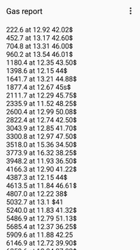

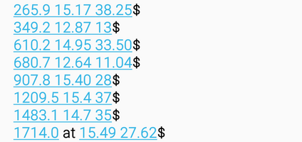

By the way, my recent trips, 180 miles highway and about 40 miles in town yield that 15.5 mpg measurement. You gave my truck the disease man! [emoji6] Nah I'm only kidding. But it's pretty bad since I'm making my trip at 72 mph with cruise control on where as just this spring I made the same trip and got about 22 mpg... I blame the fuel pump. The truck hasn't been the same since I replaced that.

My V8 Saab normally gets around 14 MPG combined +/- 0.5, DoD disabled.

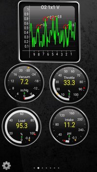

So we hit the highway and I had my torque app loaded and once we settled at 60 MPH, I noticed I had to slightly increase pedal pressure to hold 60, a little more than mine but it was noticeable. This is what I had at right around 60, flat ground, steady speed.
Granted calculated load can be sensitive, 95 is very high for a steady 60 mph cruise so the engine is just working too hard to maintain a steady speed, also only 7 to 8 inches of vacuum is quite low so that's a huge factor also.
I asked if he had 4WD and he said yes, (sorry I wasn't aware of the selector location on the TB so I didn't see it). Not to the fault of the OP, as he was not 100% clear on the 4WD operation but it was in A4WD. This will engage the front disconnect and add drag to the driveline.

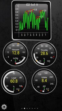

This was my screenshot after I put it in 2HI

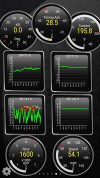

Another screenshot showing that the fuel trims seem good as well as the O2 operation.
On my envoy I have about 45-50% on the load at 60 but it's also a SWB and I have LRR tires. Now we are onto something as this will likely impact the mileage positively. The other thing that may have an impact is the aftermarket wheels and tires. I don't know for certain as of yet but with my couple years working with tires, generally the heavier 20" rims with non LRR tires will negatively impact mileage. This may not be the case here, but it's a safe assumption that they could cost the OP 1 to 2 MPG, but that's not confirmed.
Now also we have the HWY speeds at cruise as a factor, these platforms will drink fuel when we venture above 70-75 MPH. I know for a fact if I go from a decent 20 MPG at 55-60 MPH, i will certainly fall to about 17 MPG at around 80...maybe slightly less.
So for now, we have the OP using 2HI and hopefully we will get an improvement over the next few tanks.
