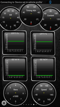

PCharm, can you get some more Torque info for me?
I know you can't get a video, but maybe with someone elses cell you could but stills are fine. Load up a screen with small gauges, get the O2 sensors with graphs, knock retard on a dial gauge, STFT and LTFT on a graph...basically set it up to look like this.
When the engine is warmed up, get a screenshot at idle, then when you are driving at about a 30 MPH cruise, then at a 60 MPH cruise.
Watch the knock retard when you are taking off, it should go from 0 to maybe a few degrees of retard then return to 0, or just stay at 0, if it stays above 0 for an extended time that could be an issue.
The o2 sensor #1 should be up and down, more when driving than idling, the #2 sensor should have a flat line or mild sawtooth but the values are what I'm after.

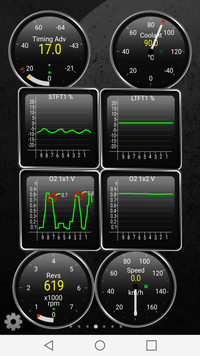

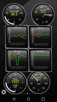

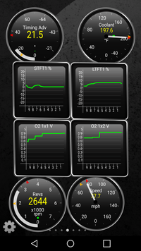

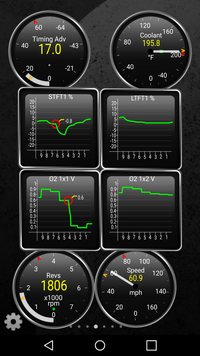

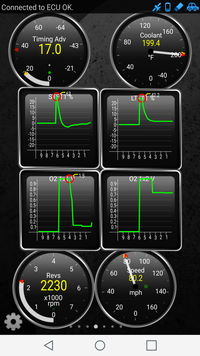

My apologies for the LONG delay. I had a lot going on and I also wasn't driving very often. Mostly street.

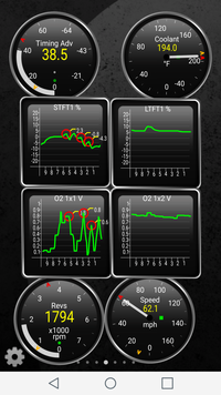

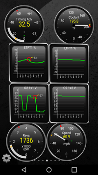

Hey gmcman. So, I learned that Knock Retard is not supported by my truck. But i configured everything else you asked for. I also didn't realize that the screenshot I took at 30mph did not go through. let me know if you need me to take another one. Or even if you need me to run the whole gamut again. I installed Track Recorder in Torque, but haven't yet figured out how to work it to record the screen. Here's the screenshots i have ...
I will try to replicate that...was that at a steady cruise?
I'm pretty sure I'm at 30 to 40 deg advance at 65 to 70 mph at steady cruise....80 is different but 17 deg is pretty low unless you're kinda coasting a little. That's why I'm curious about the knock retard.
Reactions: pcharm129
gmcman said:
if that's at cruise then that is one extremely lazy upstream oxygen sensor
Sorry. That 59mph was the wrong screenshot. Having trouble with uploading. I'm trying to correct it now. It was at 62mphScreenshot_2015-08-08-11-41-361.png...

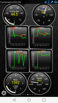

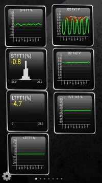

Here's a few I took of mine at cruise, something is causing your trims and O2 sensors to be out of whack.
Do you have service engine light on? Do you have AC O2 sensors less than 80K miles old?

Yeah those O2 graphs look way out of whack.
Coolant temps look a bit low to me too. Can you run coolant temp as a graph instead of a gauge? That might help define the problem. If it is consistently under 190, then it is likely the thermostat. If it rises and falls, it is likely the sensor.
It is on the lower edge but I'm not quite as concerned about that given how my truck always used to run at that temp with the original stat/sensor without any issue.

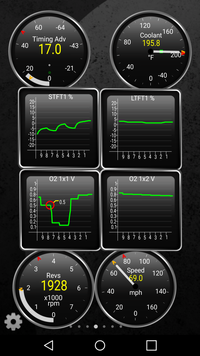

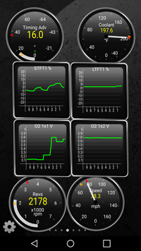

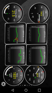

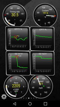

I took some more screenshots...
