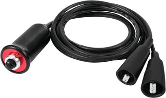

Now.... After Turning the Ignition Key to the ON Position and while Pressing the Button on the Start Cable... Measure and Record the Voltage on that RED Cable in between the Two Ends of the RED Cable ... WHILE CRANKING OVER THE ENGINE.
This can be accomplished SOLO by using THIS Push Button Starter Cable so you can observe the DC Voltage as the Current is Flowing through the RED Positive Cable. The ONLY way to conduct a Voltage Drop Test...is when the CIRCUIT IS LOADED....(Engine Turning Over under the POWER of The Starter)
